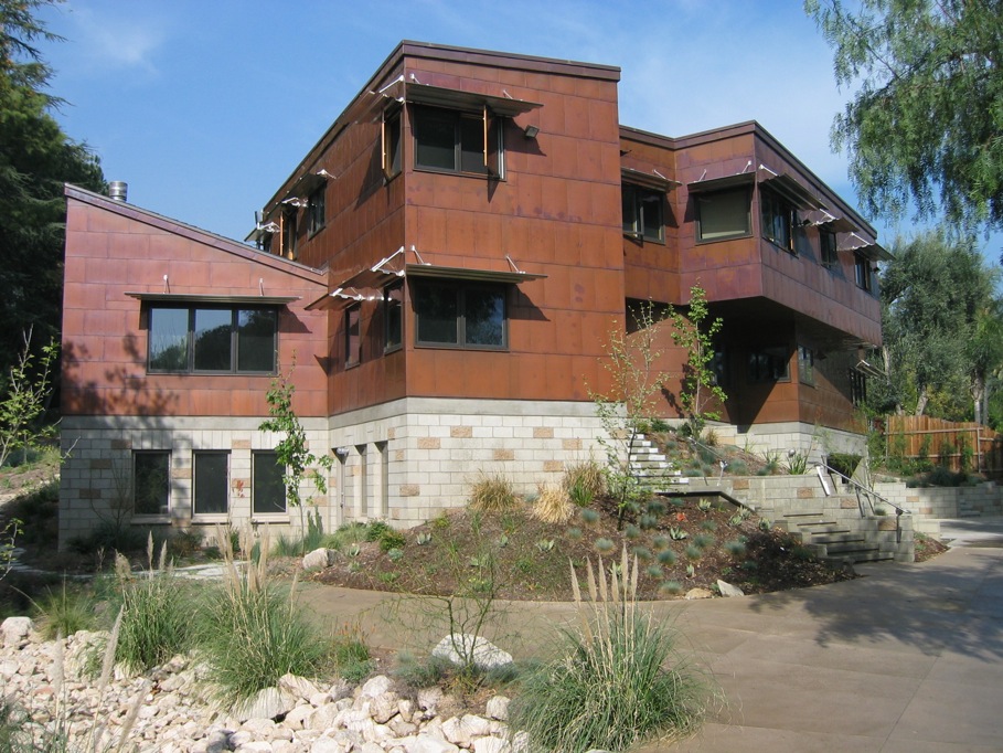

- As mentioned Craig is an Architect for his “real job.” Amazing!
- Craig’s shared some of his architectural work from his “real job” with us.
