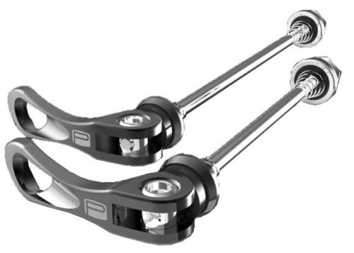

Carbon-Ti X-Lock Special
Carbon_Ti_Road_Ti_Black_Child
  • Weight: 39 grams.
  • Price: $100
  • Cam Travel: 1.4mm
  • Rod Material: Titanium
  • Rod Length: 160mm rear, 126mm front.
  • Colors: Black, Blue, Gold, Green, Red, Silver, White
Carbon ti is very nicely finished with a svelte titanium handle that not only looks good but feels solid in hand, especially given the weight.  It’s the 5th lightest out of 17 and 10th in terms of price.  The nut is very small but knurled enough so that there is plenty of grip yet not harsh on the fingers.  The cup on the cam is a 360 degree so it does not require manual alignment.   This is also one of only 2 skewers in the review that comes in white.  Certainly one of our favorite of superlight skewers.

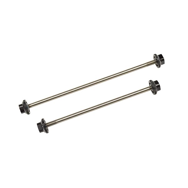

Control Tech Race
Controltech_Race_Lite_Skewers_Parent
  • Weight: 29 grams.
  • Price: $50
  • Cam Travel: Threaded
  • Rod Length: 160mm rear, 129mm front.
  • Colors: Black
The Control Tech Race is a skewer but isn’t a quick release.   Not having a quick release handle gives it a good advantage in terms of weight, it’s the 2nd lightest of all skewers we tested.  It also has an advantage in price being the 4th least expensive (2nd least expensive with ti axle).  Being a bolt on skewer gives it plenty of tightening power, ideal for those that need something light with lots of clamping power.  The drawback is that you do have to carry and use a tool for wheel removal.

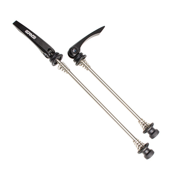

Enve Road, Titanium
Skewer_Enve_Ti_Parent
  • Weight: 57 grams
  • Price: $58
  • Cam travel: 1.5mm
  • Rod material: Titanium
  • Rod Length: 158mm rear, 128mm front
  • Colors: Black
Enve has recently changed their skewer design.  The ti lands 12th out of 17 in terms of weight.   It has an average size handle and a fairly large nut which makes use a snap.  It’s available in both steel and ti but with the small price difference the ti is definitely the more appealing of the two versions.  The cam action can be a little sticky during operation.

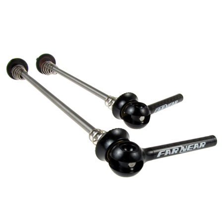

Far and Near Carbon Road
farnear_skewers_black
  • Weight: 42 grams
  • Price: $70
  • Cam Travel: 2.3mm
  • Rod Length: 157 Rear, 125 front.
Very similar in design to the original Kcnc. It has a long handle and good retention.
Very basic and trouble free design. Handle is comfortable to grip for both closing and opening which is a good thing
being that this skewer has one of the largest cam movements of all the skewers. Solid clamping force and overall
nice design at a good price. The carbon wrap over the handle sometimes has a bit of a laminate look which won’t
appeal to everyone. But functionally there is nothing to fault here.

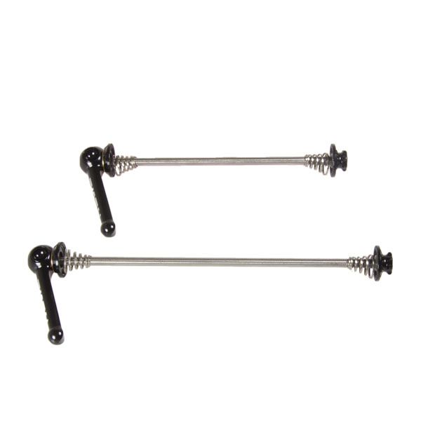

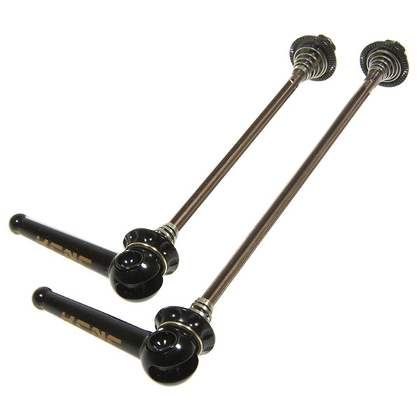

Kcnc Titanium Road
kcnc_ti_skewer_black
  • Weight: 40 grams
  • Price: $72
  • Cam Travel: 1.8mm
  • Rod Length: 155 rear, 122 front
This is one of the best selling lightweight skewers of all time. It mixes the traits very
well and for this year has received several updates. Like the Z6 this one also includes the coating on the brass
plate to quiet and smooth out operation. More importantly the handle has been lengthened by 5mm which we feel makes
a lot of difference. That was our only real complaint with the original and now it’s even better. Secure clamping,
easy function and easy on the hand. Weight, performance and price considered this has to be one of the best on the
market.

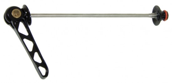

Kcnc Groove Road
kcnc_grooving_skewer_black
  • Weight: 35 grams
  • Price: $95
  • Cam Travel: 1.8mm
  • Rod Material: machined titanium
  • Rod Length: 158 rear, 124 front
This is a lightened version of the Kcnc Ti road. It is identical to the Ti road but with
two changes. The main change is that the titanium shaft is machined out on 4 sides which shaves 5 grams of weight.
The other is that the logos are changed to gold. Overall this is just as good a skewer as the standard ti but with
less weight and an increase in price.

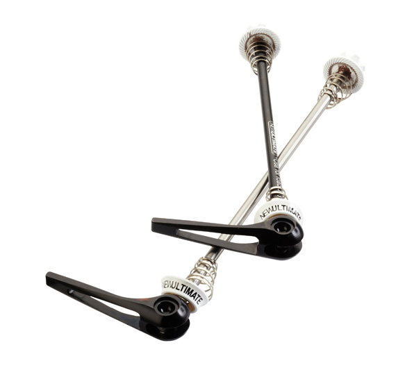

New Ultimate Road
newulti_qr_white_a
  • Weight: 40 grams
  • Price: $90
  • Cam Travel: 1.7mm
  • Rod Material: Titanium rear, Aluminum front
  • Rod Length: 156 rear, 125 front
  • Colors: Black, Red, White
The New Ultimate also has a mixed shaft, titanium rear and aluminum front. Similar design
with a ball and brass socket cam to Kcnc and Far and Near. The New Ultimate has one of the nicest looking shapes on
the handle, but at the same time one of the least friendly on hand.  It’s especially nice that it is available in white which is something hard to find in skewers.

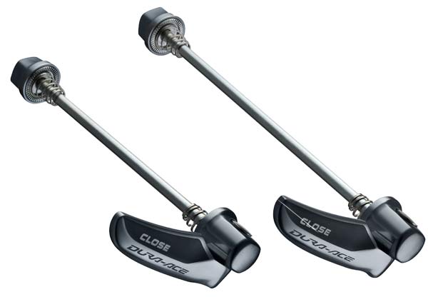

Shimano Dura Ace 9000
2013-Shimano-Wheels-WH9000-QR-011
  • Weight: 127 grams
  • Price: $140
  • Cam Travel: 2.0mm
  • Rod Material: Steel
  • Rod Length: 165 rear, 130 front
  • Colors: Silver
The 9000 skewer is big, heavy and expensive, but it works like nothing else. At up to 5
times the weight of all the other skewers in the review this one seems a bit out of place. It’s here to show
differences from mainstream to more unique brands. Shimano does not design skewers to be light, they design them to
be functional. With that in mind it’s a total success. It’s handle is the easiest of all on the hand making it the
most comfortable to use. Clamping strength on the Dura Ace skewer is unmatched by virtually any traditional quick release in the market, which is why even trials riders choose them to hold their wheels in place. If weight, price and aesthetics are of no
concern and the only thing that matters is performance this is a good choice.

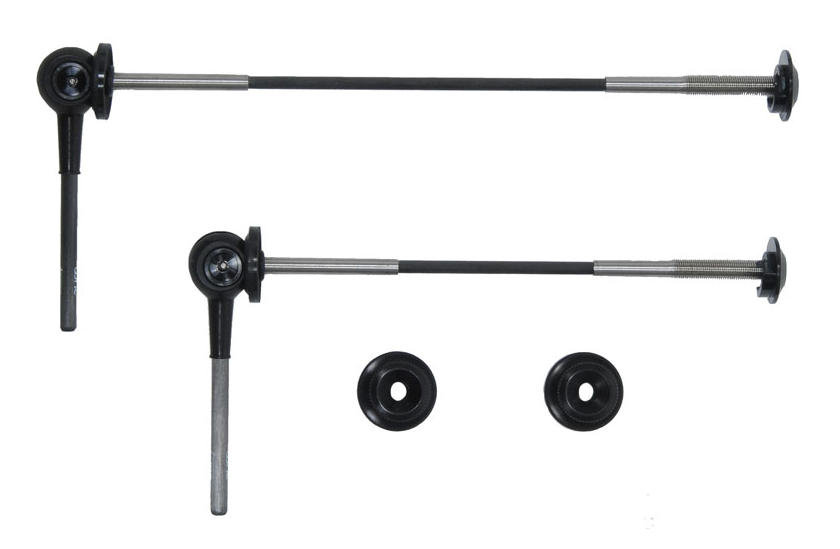

Tune U20
1717_294043
  • Weight: 21 grams
  • Price: $205
  • Cam Travel: 1.1mm
  • Rod Material: Carbon Fiber.
  • Rod Length: 160 rear, 125 front
  • Colors: Black, Blue, Gold, Green (2 shades)
    Orange, Pink, Purple, Red, Silver
When weight is the bottom line, this is really the only choice. At 22 grams there is no
other quick release skewer equal in weight that we are aware of.  Like all the other skewers in the review there is no
weight limit on them even given their light weight nature. These are truly show pieces and deserving of being seen
outside of a hub where they can be appreciated, but that also comes at a hefty price.

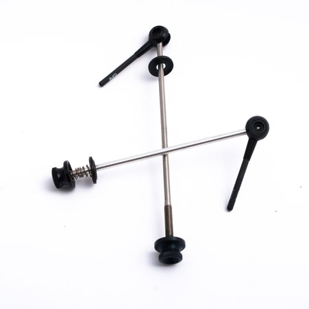

Woodman

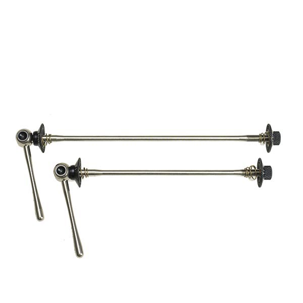

WOODman_Gator_Ti_Skewer_Black_Child
  • Weight: 60 grams
  • Price: $60
  • Cam Travel: 1.6mm
  • Rod Length: 160 rear, 126 front
Woodman designed this skewer with an eye on balance.  Not heavy, but not light.  Not terribly expensive, but still using titanium for the shaft.  They handle is large and easy to use.  The nut is small to help keep the weight down but not too small.  They also opted to not use the delrin bushing in the cam, which results in a little more friction but gives the skewer much better grip and longevity since there is no delrin to compress.
