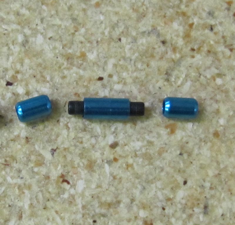

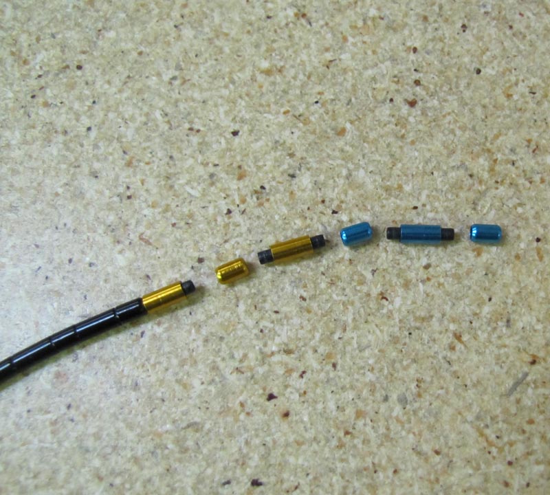

Similar in concept to Nokon or Alligator I-link, the Bungarus is a segmented housing. Unlike Nokon and Alligator it’s a 2 part segment. There are short (6mm) pieces and long (8mm pieces) The 8mm piece is the key, it has it’s own liner built in which is 13.5mm so it extends out of both ends of the segment. The smaller segments fit onto these extensions. The built in POM can be thinner than a traditional inner liner which allows for a thinner outside. The outer diameter of the cable housing is a scant 3.8mm which is not impressively small compared to 4mm shift housing, but again when compared to 5mm brake housing it is a dramatic difference.

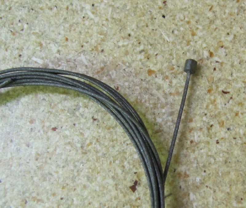

So we’ve probably said enough about the weight how about the other aspects, particularly the performance. I tested it on my 29er and performance is spot on. They work really well, as well as any of the other segmented housings we’ve used in the past. One nice feature that contributes to the good performance is the fact that the kit comes stock with nano-teflon cables sometimes called DLC cables. Expensive cables yes, but the coating on them is much more durable than the coating on standard Teflon cables that you find in other kits so they have the longevity advantage. Also with the nan0-teflon you don’t get coating scratching off and balling up inside the housing as is possible with some Teflon cables.
