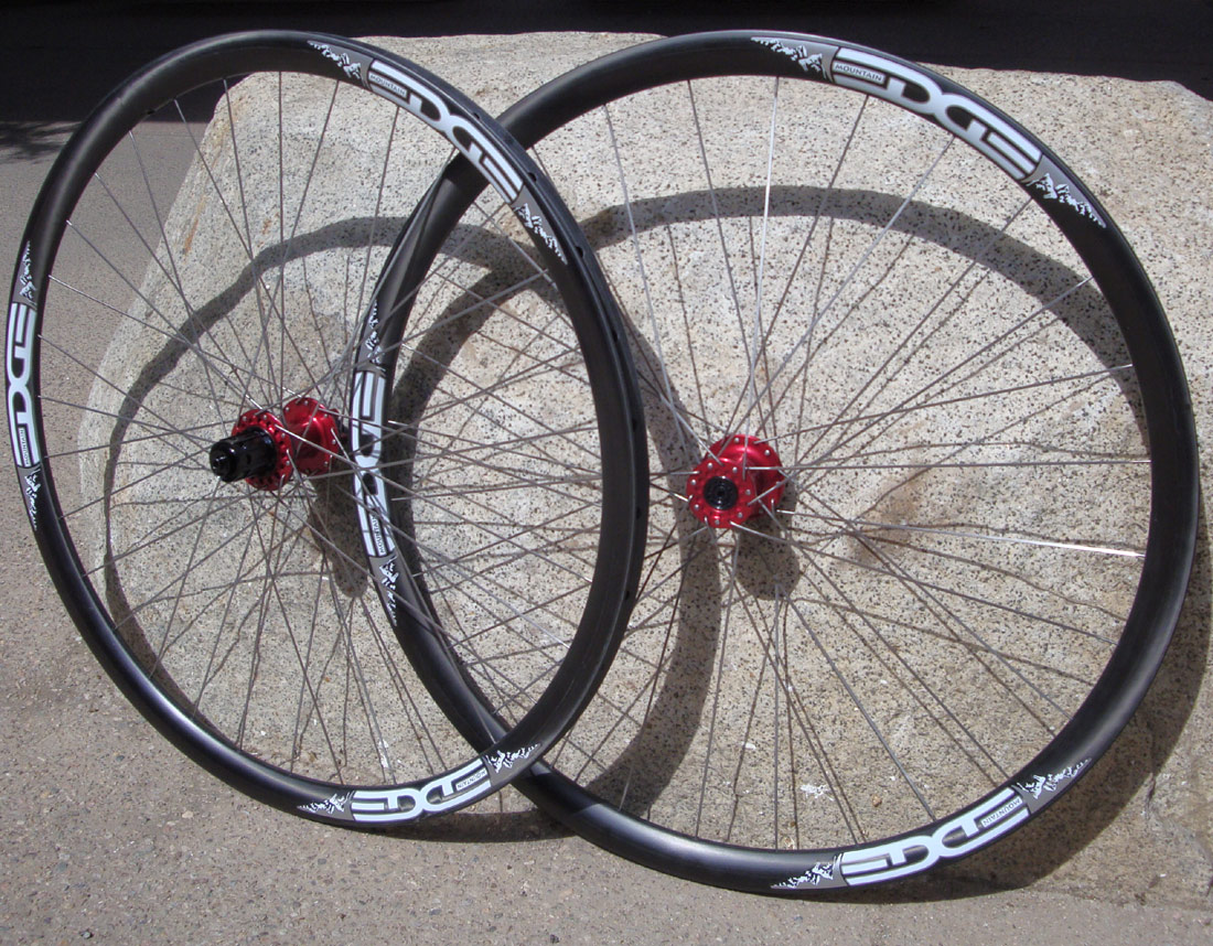

So without further ado I present you with our 943 gram (actually it’s 942.7 grams to be precise.) 29″ tubular wheelset.

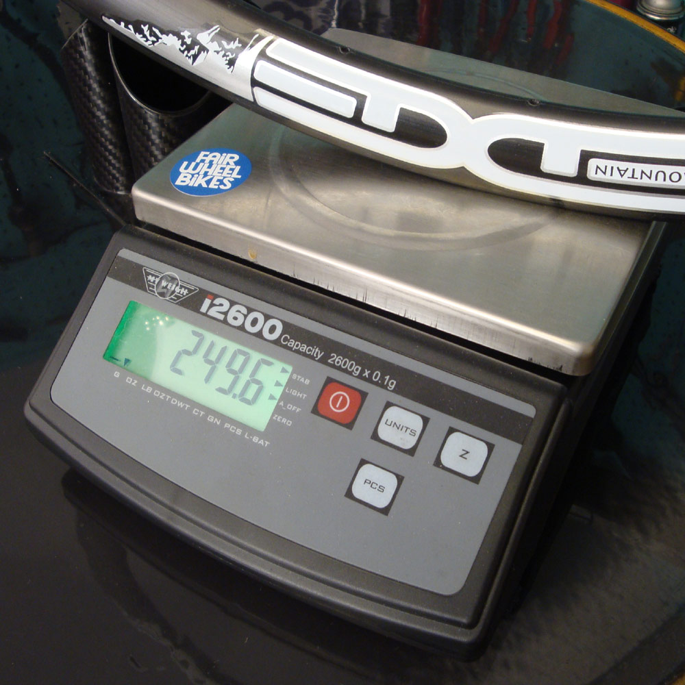

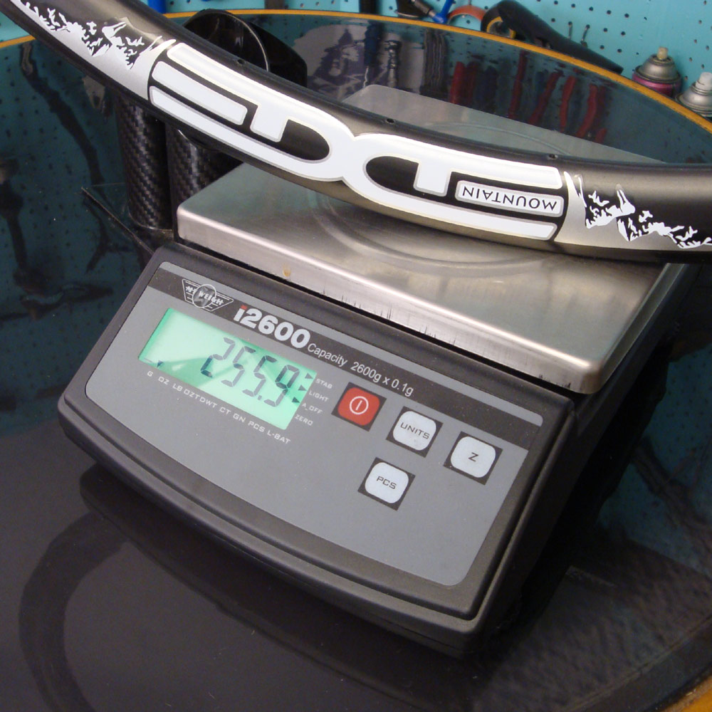

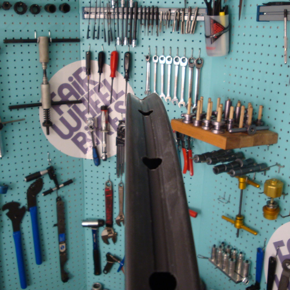

We began with some hand picked tubular 29″ Edge rims weighing 256 and 250 grams each. Made in Utah, the Edge rims are not only light but incredibly stiff. The 32mm deep and 25.5mm wide rims are So stiff that it allows for a lower spokes count or simply a much stiffer wheel than their aluminum counterparts in the same drilling. Because of this we felt very comfortable using only 28 ti spokes in the front.
The ti spokes that we choose were the new Pillar PST X-tra. A 2.2x.95mm titanium bladed spoke. To hold them in place we used the matching Pillar nylock nipples. 28 spokes were laced 2 cross in the front wheel and 32 spokes were laced 3x in the rear wheel.

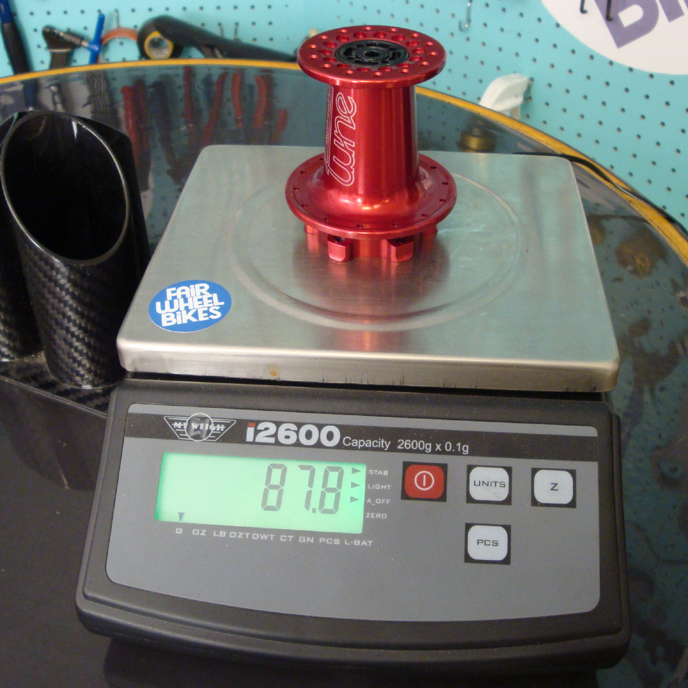

For the front hub we choose a not quite standard Tune Cannonball hub. The hub was a mix of ideas and would technically fall in between the standard and SL versions(except that it’s not a production version.) The already under claimed weight hub was tuned with a ceramic bearing upgrade reducing the weight down to 88 grams, including the mounting bolt and cap.

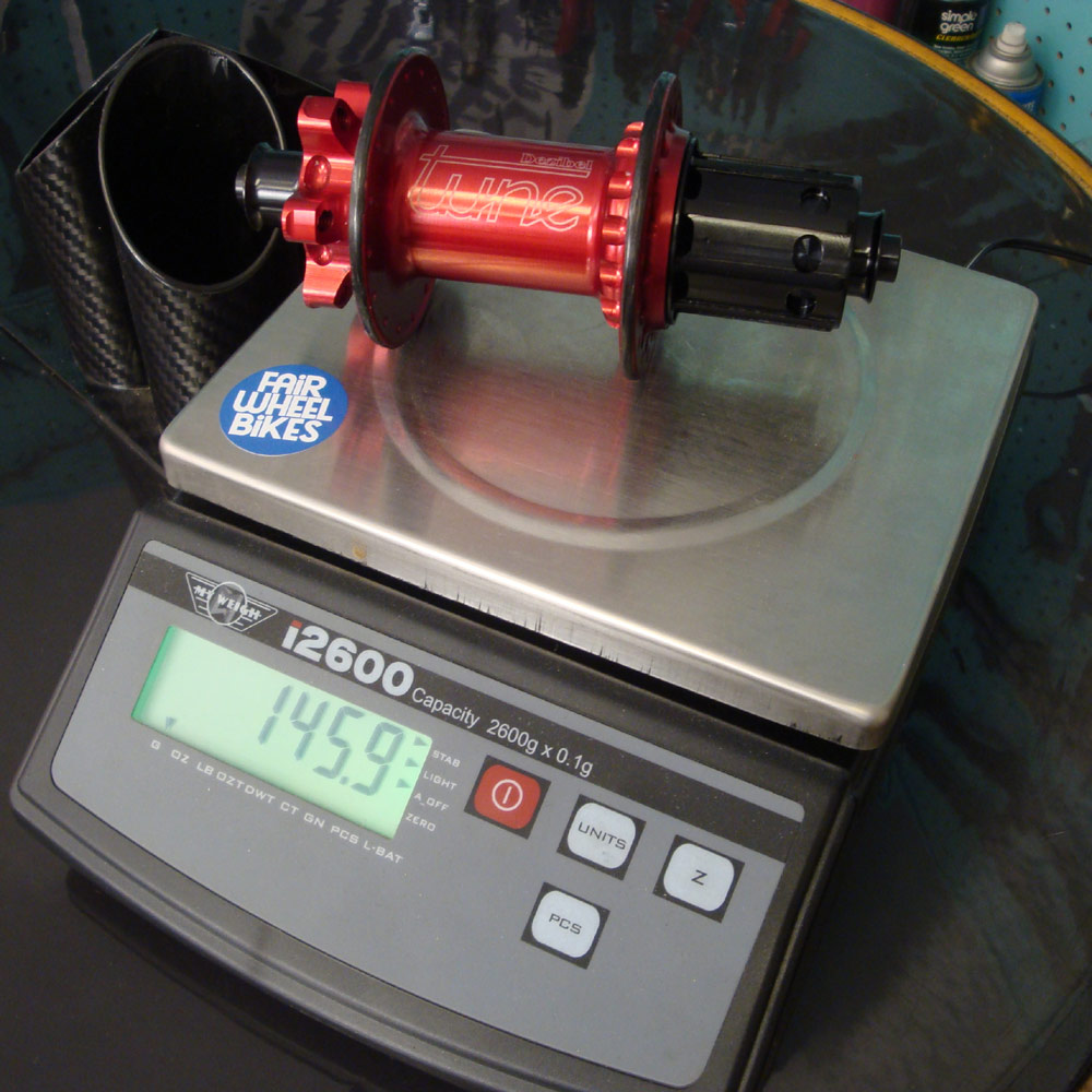

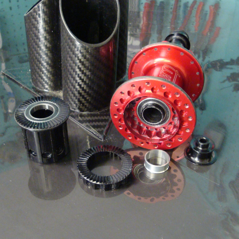

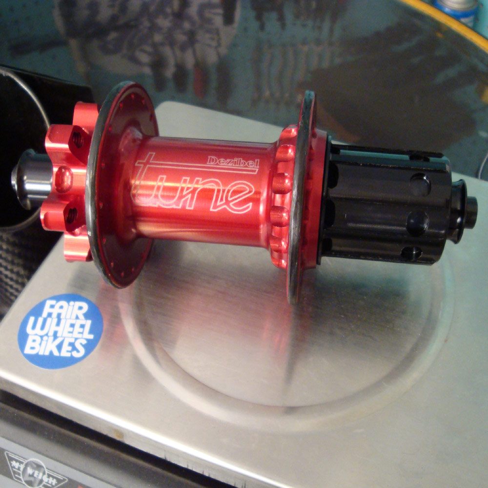

For the rear hub, we had to call in a big favor. Our friends at Tune provided us with a Prince Dezibel rear hub. Taking what will already be the lightest hub rear mtb hub in the world when it hits the market later this year, and doing just a little tuning in the bearings resulted in an incredible 145.9 gram rear hub. The Dezibel is a big departure for Tune from their traditional pawl hubs, but the new design is what allows such large weight savings. Taking a ratchet system design similar in concept to DT or Soul-Kozak but simplifying it down has really made a difference. Rather than using two plates that are separate pieces to engage, they use only one plate made out of hardened alloy and the second plate is machined as part of the free hub body. In place of springs they use magnets with like charges to repel each other. The hub is really quite an engineering feat. I continue to be impressed with how Uli and the guys at Tune continue to push the envelope and slowly whittle away at the weights.
