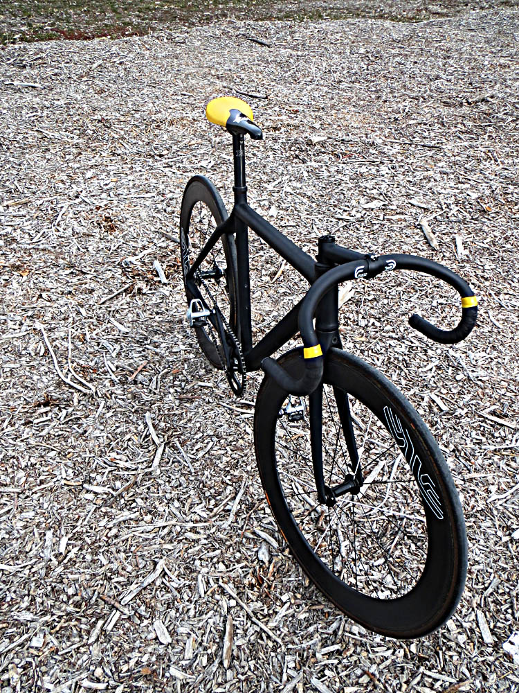

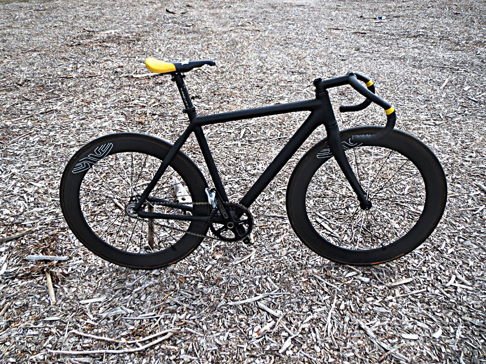

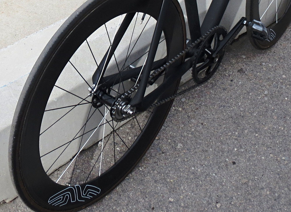

Several years ago I had a Scott CR1, which at the time was my favorite frame. During some pulley wheel testing, a mishap led to the destruction of the frame. Considered destroyed because of it’s non-replaceable hanger. Also destroyed were the derailleur and rear Lightweight. Being a favorite frame of mine it didn’t get recycled but rather just hung up in the rafters as a memory. Some years later it we decided to pull the frame down and breath some new life into. It was sent off to a friend and custom carbon frame builder, Bre Ruegamer. The non-removable hanger/dropout combo was removed and replaced with custom machined horizontal dropouts. At the same time the rear end of the frame was re-spaced to narrow it by 10mm so it would accept a 120mm fixed gear hub. Then the frame, fork and stem were stripped and repainted with matte black. It was rebuilt without having an eye on choosing lightweight parts and finished weight is just over 12 pounds.
