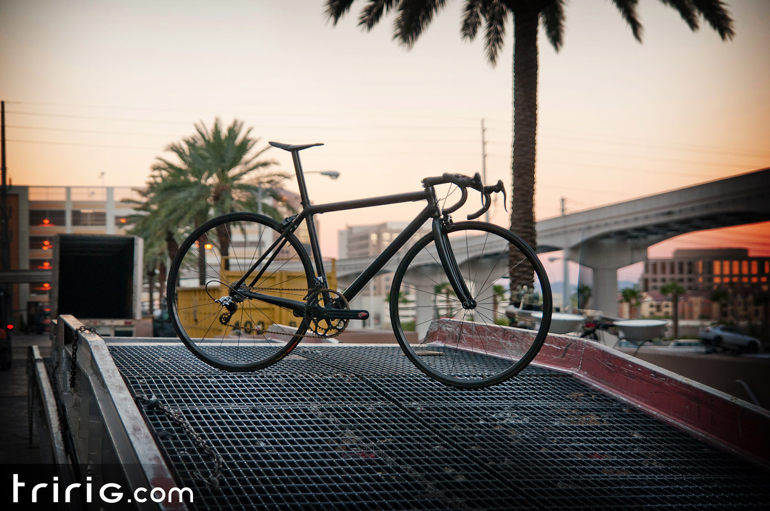

Over the last weekend CyclingNews reported on one of our old projects, the worlds lightest bike. This now seems like a good time for us to revisit this project as well. It also seems like a good time to mention that this project is the inspiration for two of our upcoming Interbike projects. No, we’re not going to make a lighter bike, as there doesn’t seem a point since this is still the current record holder. We will however be offering two new projects both with an eye on total weight, yet keeping with a more generally accepted idea of all around use.

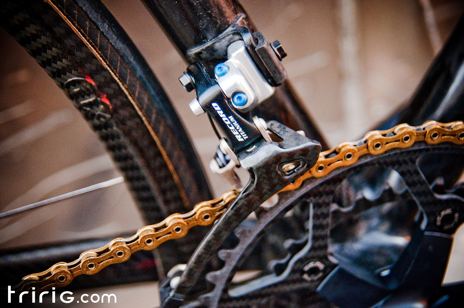

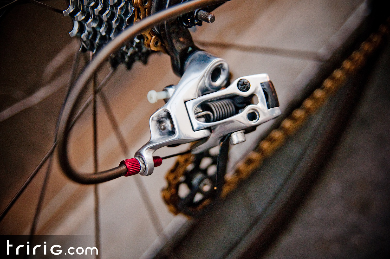

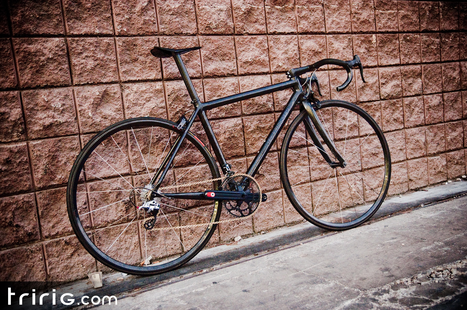

Build List, 6.16 lbs (2.794 kg)
- Frame: Spin
- Fork: THM Custom

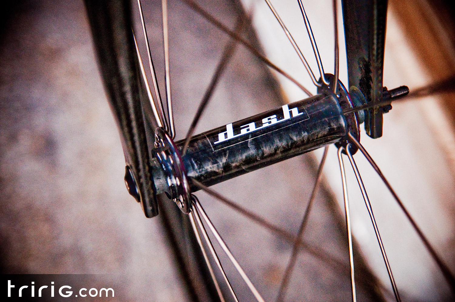

- Wheels:
- Rims: Ax Lightness Custom
- Hubs: Dash prototype
- Spokes: Pillar titanium
- Tires: Tufo Custom
- Skewers: Tune

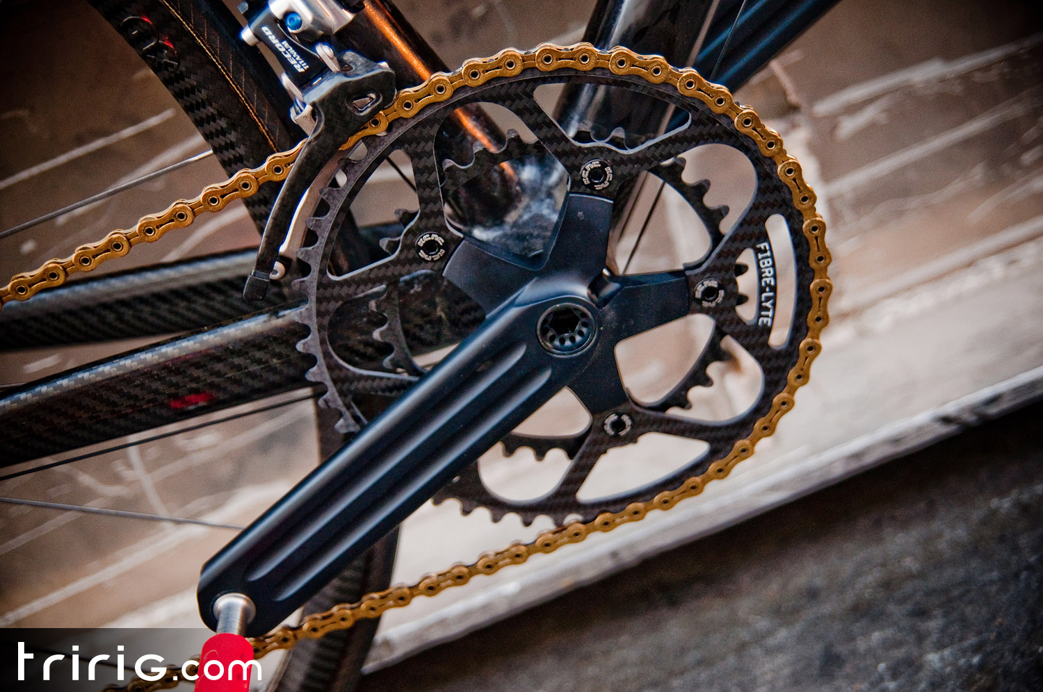

- Chainset: Myth prototype

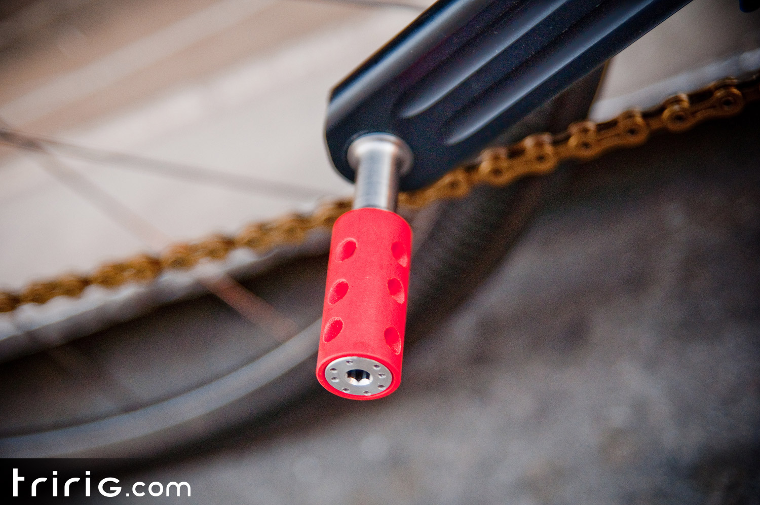

- Pedals: Aerolite
- Bottom Bracket: HSC Full Ceramic
- Chainrings: Fibre Lyte Custom

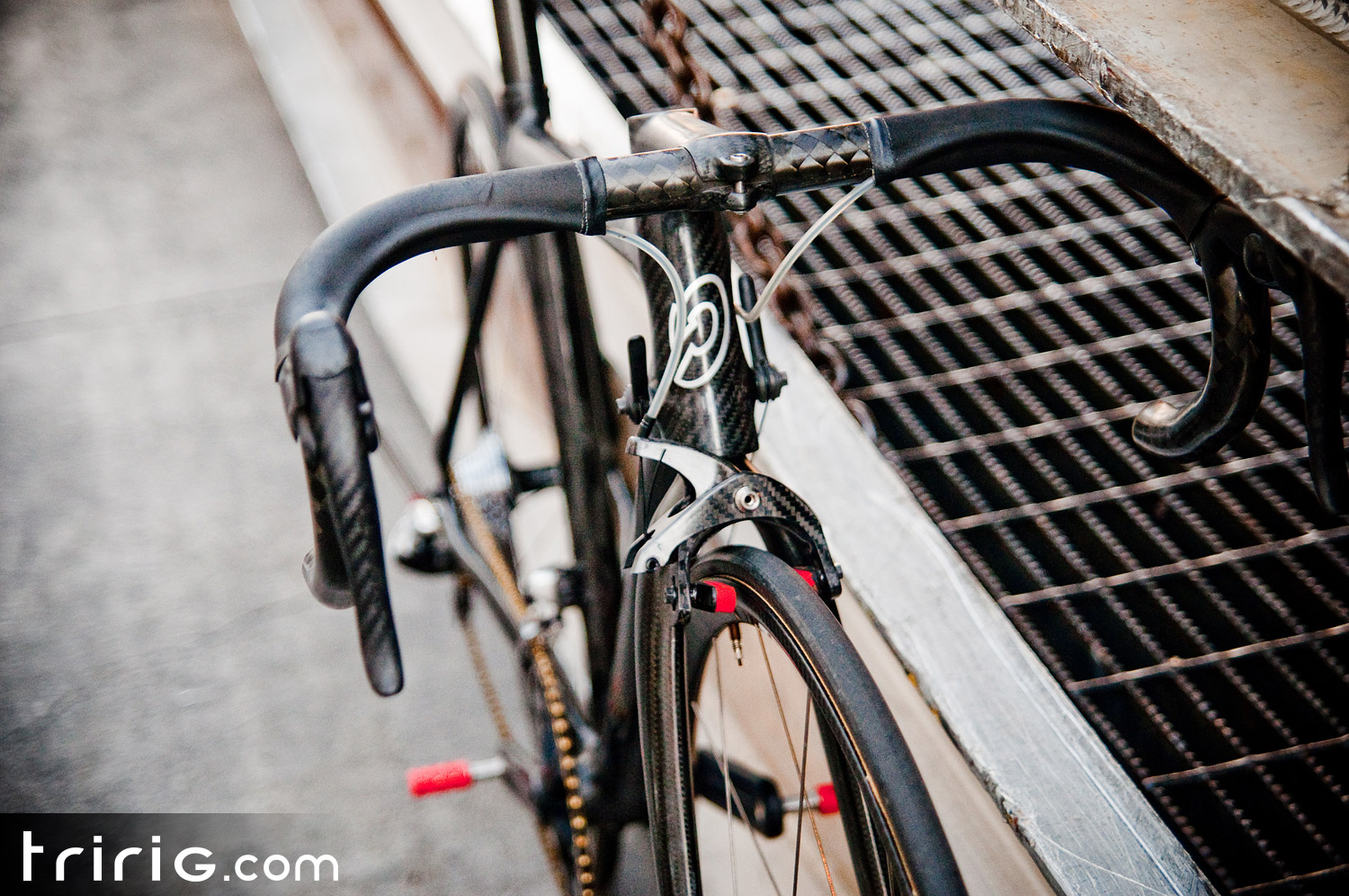

- Levers: Campag Record custom
- Bars: Schmolke TLO custom
- Stem: NoRa custom
- Saddle/post combo: Custom Tune/Schmolke
- Seatpost clamp: BTP
- Front Mech: Campag Record custom
- Rear Mech: Sram Red custom
- Chain: YBN Titanium
- Cassette: Recon Alloy

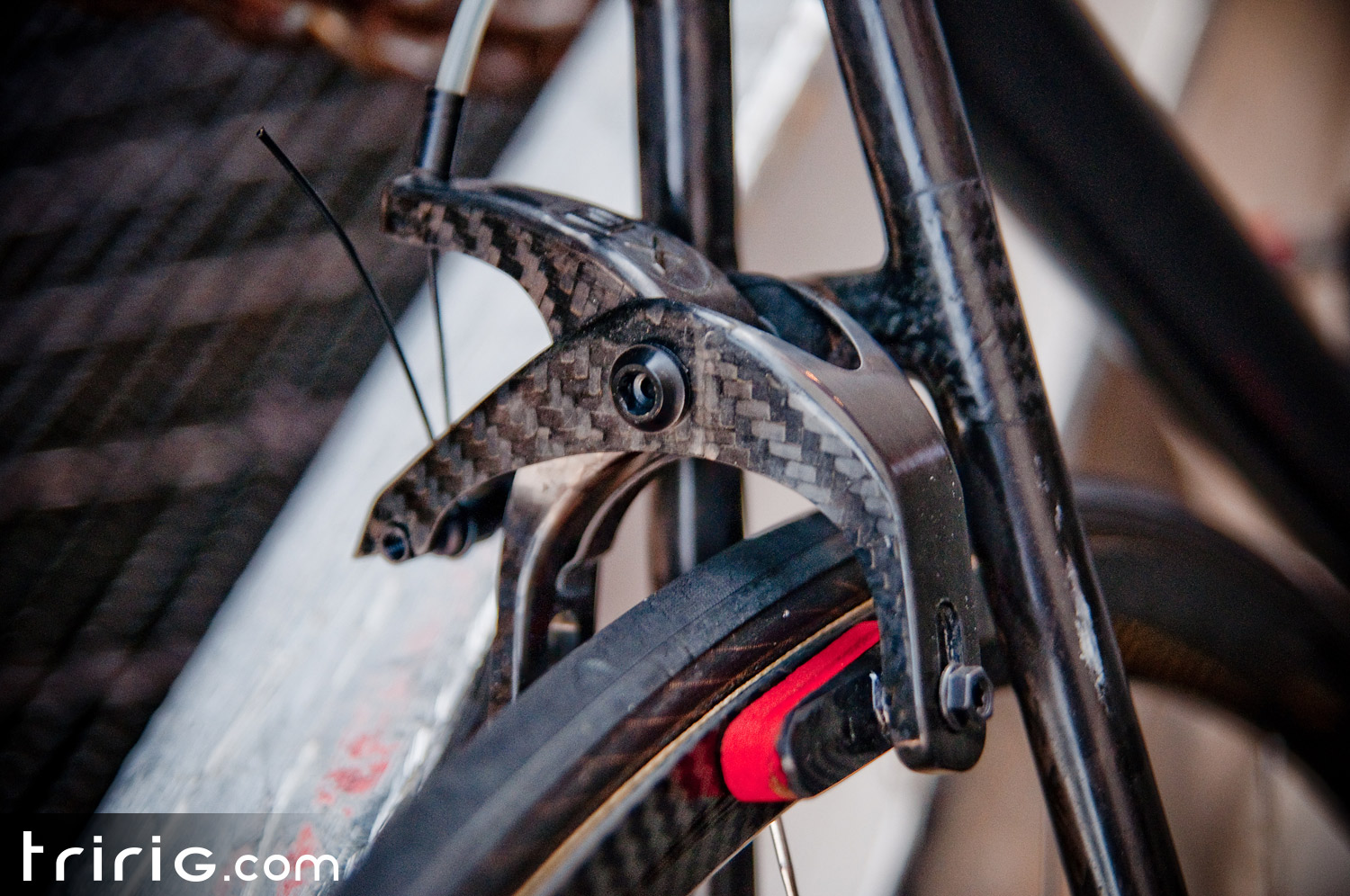

- Brakes: Ax Orion premium
- Cable set: Power Cordz
