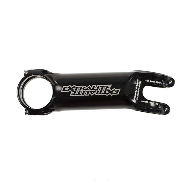

| Extralite | Hyperstem | 40 | 5.37 | 81.4 | 2.29 | 7075 | Titanium | |

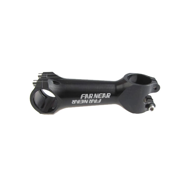

| Far and Near | S1 | 38 | 3.92 | 144 | 1.77 | 6061 | Steel | |

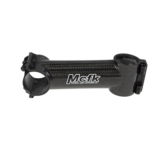

| Mcfk | Carbon | 44 | 4.74 | 88.6 | 2.39 | Carbon | Titanium | |

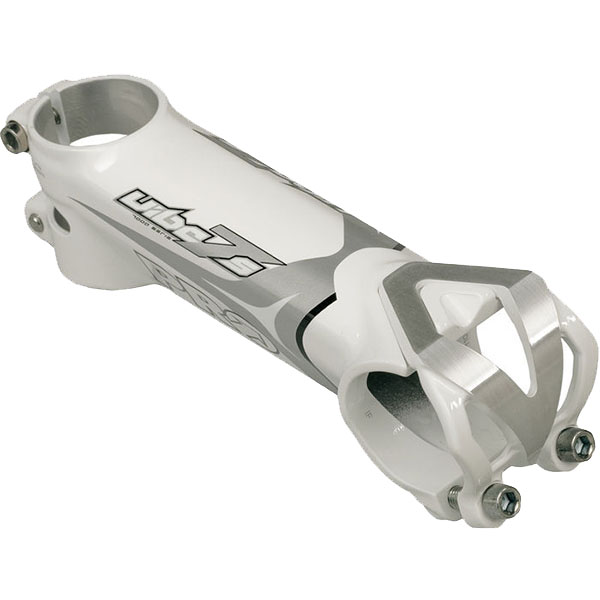

| Pro | Vibe 7S | 44 | 4.06 | 137.3 | 1.79 | 7075 | Steel | |

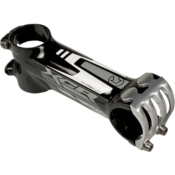

| Pro | XCR | 39 | 5.38 | 117.6 | 1.58 | 7075 | Steel | |

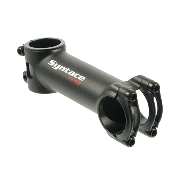

| Syntace | F119* | 40 | 4.55 | 132.2 | 1.66 | 7075 | Steel | |

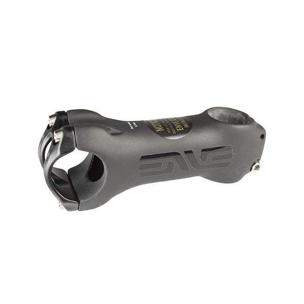

ENVE Carbon
A full carbon stem with the 2nd highest stiffness to weight ratio of all tested stems. Not only that, the ENVE Carbon stem is good looking and available in a full range of sizes. Full carbon construction should provide additional vibration damping over alloy stems. Textured face plate adds to it’s ability to hold a bar in place with lower torque which reduces the chance of damaging a lightweight carbon bar. Includes ti bolts but is a bit more expensive than alloy counterparts.
- Manufacturer: Enve
- Model: Carbon
- Stack Height: 41mm
- Avg: Def: 4 mm
- Weight: 120.1 gr.
- SxW: 2.07
- Material: Carbon Fiber
- Bolt Material: Titanium
- Angle: 6 degree
- Price: $265
Extralite Hyperstem
The Hyperstem is an update to the OC Road stem. There were some small changes, the most notable is the logo. The new logo allows for the stem to be run either up or down which was a complaint about the older version. The other change is the angle from 8 degree to either 6 or 12 degree for the new one. The weight has dropped slightly as has the stiffness though neither changed significantly, but the weight went down more than the stiffness which means this one tops the old version in stiffness to weight ratio. The finish quality is top shelf just as the previous version was, great looks certainly helps make this a top choice for many riders. If I had to have a complaint it would again be that it lacks some sort of knurling internally to help prevent bar slippage.
- Manufacturer: Extralite
- Model: Hyperstem
- Stack Height: 40mm
- Avg: Def: 5.37 mm
- Weight: 81.4 gr.
- SxW: 2.29
- Material: 7075
- Angle: 6 degree
- Price: $210

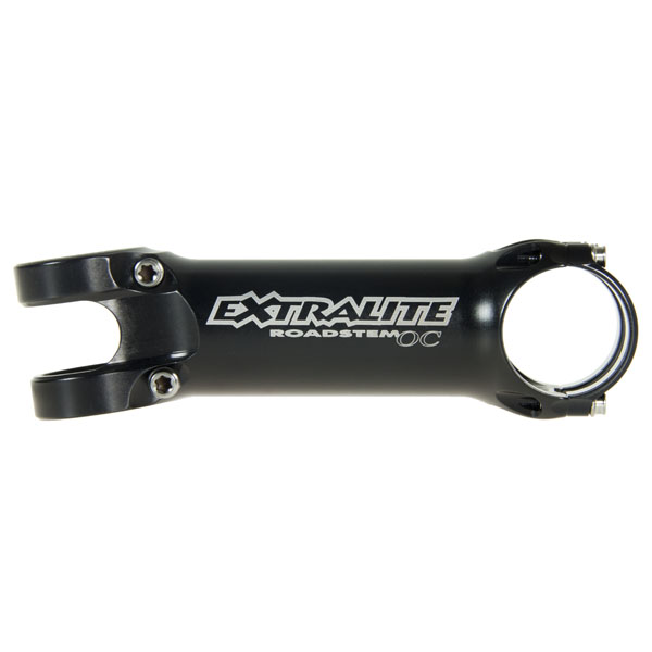

Extralite OC Road
One of the lightest stems that we tested. In spite of being near the bottom in terms of deflection it still comes in with one of the best stiffness to weight ratios thanks to it’s super light weight. Extralite lists the stem as being reversible but logos printed in only one direction make us think nobody would run it in a rise position. It’s more expensive than all the other alloy stems in the test, but it is exquisitely made and has very nice attention to detail with items such as the custom torx head titanium bolts. We would like to see some sort of gnurling on the inside of the face plate to help with bar slippage issues that have occasionally been reported.
- Model: OC Road
- Avg: Def: 5.06
- Weight: 87.7 gr.
- SxW: 2.25
- Material: 7075
- Angle: 8 degree
- Price: $230
Far and Near Sl
This stem was a surprise to us. Scoring 6th in deflection gives it a well balanced stiffness to weight ratio, which could be improved upon with the addition of some titanium bolts. It is available in a full range of lengths in both white or black with a range of colored faceplates.
- Manufacturer: Far and Near
- Model: S1
- Stack Height: 38mm
- Avg: Def: 3.92
- Weight: 144.0 gr.
- SxW: 1.77
- Material: 6061
- Bolt Material: Steel
- Angle: 6 degree
- Price: $85

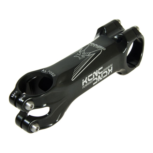

KCNC Arrow
Available in both 7 and 17 degree the Arrow stem offers more choices in fit than most stems in the test. The small titanium bolts do tend to strip in the head fairly easy. It falls right into the middle of the spectrum in terms of deflection making it a pretty good all around stem.
- Manufacturer: Kcnc
- Model: Arrow
- Avg: Def: 4.28
- Weight: 138.6 gr.
- SxW: 1.68
- Material: 7050
- Angle: 7 degree
- Price: $90

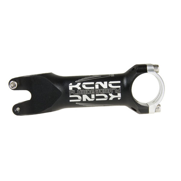

KCNC Flyride
The Flyride is the least expensive stem we tested in this round. It’s available in 26.0mm and 31.8mm clamp sizes to fit numerous road and mtb handlebars. Even with it’s steel bolts it’s on the lighter side of the stems in the test and falls right in the middle of stiffness to weight ratios.
- Model: Flyride
- Avg: Def: 4.55
- Weight: 127.3gr
- SxW: 1.72
- Material: 6061
- Angle: 5 degree
- Price: $45
MCFK Carbon
Being one of the lightest stems in the test the Vorbau packs some serious stats. In fact only the 2 Extralite stems were lighter. The big surprise with this stem is that for it’s weight it tested extremely well in stiffness, almost matching the much heavier Ritchey Superlogic carbon. Just pushing past the lighter Extralite stems in terms of stiffness to weight. The finish of the stems is what would generally be considered artisinal, and not perfect. It’s definitely a case of function over form. The over 180 opening is kinder on lightweight carbon bars when clamping, but also makes the bar more difficult to install and remove. The drawback to the Mcfk is that it’s the most expensive stem in the test.
- Manufacturer: Mcfk
- Model: Carbon
- Stack Height: 44mm
- Avg: Def: 4.74 mm
- Weight: 88.6 gr.
- SxW: 2.39
- Angle: 6 degree
- Price: $329

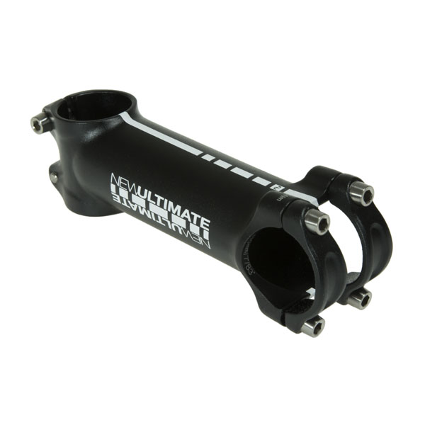

New Ultimate Evo
The New Ultimate Evo is on the lighter end of stems in the test, 3rd lightest tested. Deflection is higher than most stems which puts it just short of middle position in terms of stiffness to weight ratios. The New Ultimate does however have a 90kgs rider weight limit. It includes titanium bolts and has a unique face plate attachment method that is claimed to significantly reduce stress on a carbon bar. Available in a full range of sizes from 7cm to 13cm and in both black and white.
- Manufacturer: New Ultimate
- Model: Evo
- Avg: Def: 5.3
- >Weight: 110.8gr
- SxW: 1.70
- Material: 7050
- Angle: 6 degree
- Price: $115
Pro Vibe 7s
Most of the Pro stems tested fell to one extreme or the other, the 7s is definitely the most well balanced of all of them. Falling right in the middle in terms of weight and deflection it ends up a little better than middle (11th out of 125) in terms of stiffness to weight ratio making it one of the most well rounded stems in the test. Has a unique puzzle lock faceplate attachment method and is available in a full range of sizes in both black and white.
- Manufacturer: Pro
- Model: Vibe 7S
- Avg: Def: 4.06
- Weight: 137.3gr
- SxW: 1.79
- Material: 7075
- Angle: 10 degree
- Price: $100

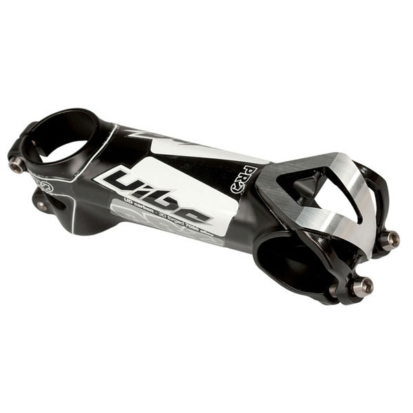

Pro Vibe Carbon
As far as we can tell the Vibe carbon is a 7s with some material removed and replaced with carbon, which does not seem to work in it’s favor. In terms of weight it’s almost identical to the 7s but in terms of deflection it scores on the low side, being 4th from bottom. That drags it’s stiffness to weight ratio down to the bottom position in the test. Available in full range of sizes from 8cm to 14cm.
- Manufacturer: Pro
- Model: Vibe Carbon
- Stack Height: 39mm
- Avg: Def: 5.24
- Weight: 138.4gr
- SxW: 1.38
- Material: Alloy/Carbon
- Angle: 10 degree
- Price: $180

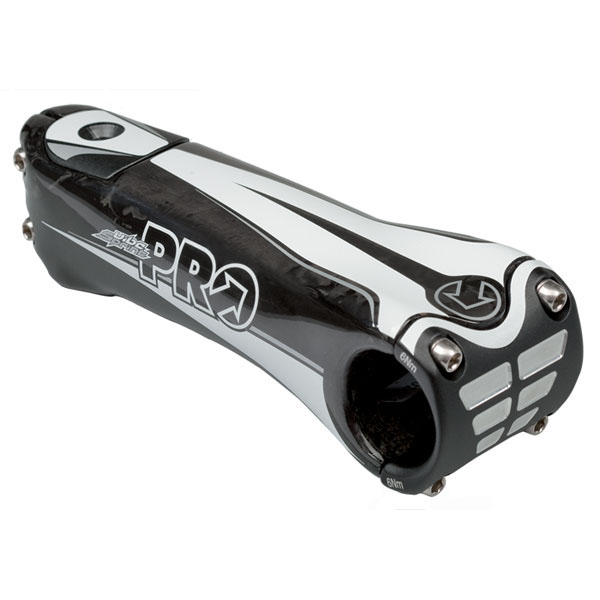

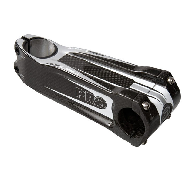

Pro Vibe Sprint Carbon
This was the stiffest stem tested by a large margin. (not considering the very similar Pro Vibe Track) This was the 2nd heaviest stem in the test though, beating only the Pro Vibe Track. It should be noted that this stem was a 10.5 when almost all others in the test were 11cm. Obviously this stem wasn’t built for the rider concerned with weight, only the one concerned with absolute stiffness, and still it managed to snag 9th spot in terms of stiffness to weight.. Available only in a few sizes.
- Manufacturer: Pro
- Model: Vibe Sprint Carbon* (10.5cm)
- >Stack Height: 39mm
- Avg: Def: 2.69
- Weight: 199.4gr
- SxW: 1.87
- Angle: 10 degree
- Price: $270

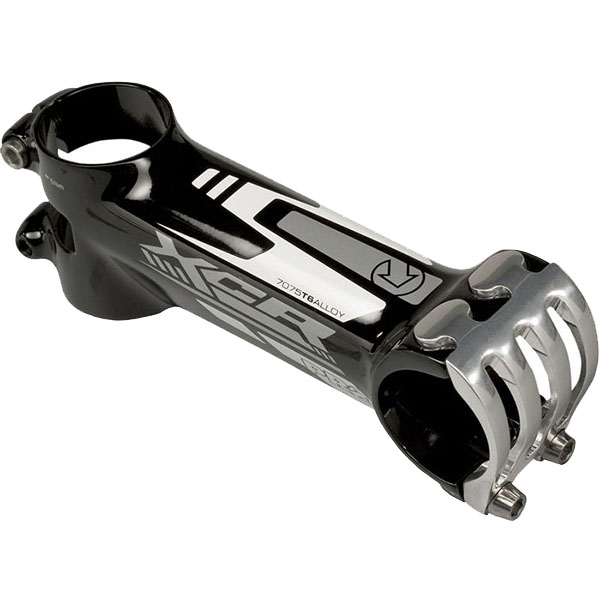

Pro XCR
The Pro XCR was the 2nd from the bottom in terms of deflection of all the stems tested. It is one of the lighter stems, being the 7th lightest in the test, but the poor deflection test pushed it’s stiffness to weight ratio down to 3rd from the bottom. Being that it’s not that different from the 7s We have to wonder if the a big part of that was caused by the difference in the upper attachment point for the face plate. Available in a full range of sizes.
- Manufacturer: Pro
- Model: XCR
- Avg: Def: 5.38
- Weight: 117.6gr
- SxW: 1.58
- Material: 7075
- Angle: 5 degree
- Price: $100

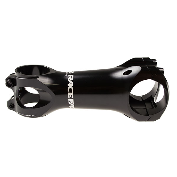

Race Face Turbine
The Race Face Turbine posted average deflections, right in the middle of the field. However it was a little bit heavier than average which dragged down it’s stiffness to weight ratio to 6th from bottom. The stem does though have a very appealing shape and is nicely finished.
- Manufacturer: Race Face
- Model: Turbine
- Avg: Def: 4.38
- Weight: 144.0gr
- SxW: 1.59
- Material: 7075
- Angle: 6 degree
- Price: $95

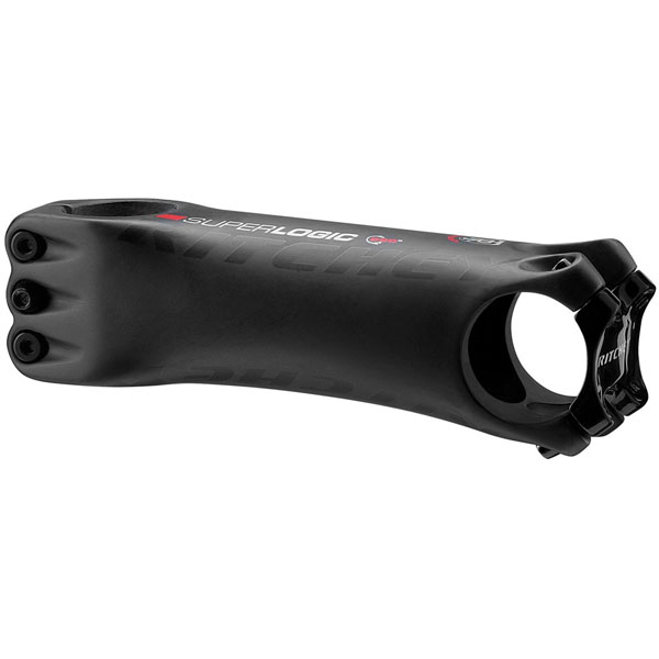

Ritchey 260 Carbon
The Superlogic 260 is a carbon version of the 260. It’s heavier and it’s slightly stiffer than the alloy 260 which results in a lower stiffness to weight ratio being in the bottom half of tested stems compared to the alloy version which was in the top half. It’s also quite a bit more expensive than the alloy version. It also shares the same pros and cons as the 260 being that it puts less stress on the bar but also makes bar installation and removal more time consuming. Overall it’s a very good looking stem.
- Manufacturer: Ritchey
- Model: Superlogic 260 Carbon
- Stack Height: 42mm
- Avg: Def: 4.67 mm
- Weight: 128.0 gr.
- SxW: 1.67
- Angle: 6 degree
- Price: $270

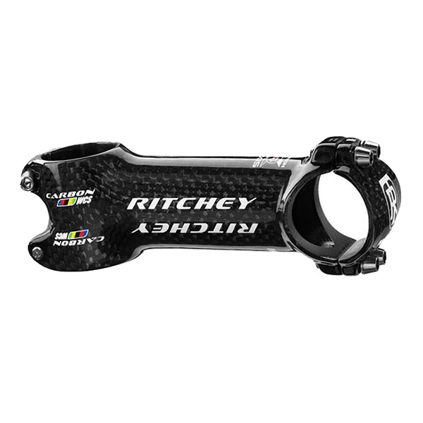

Ritchey 4-Axis Carbon
Unlike the 260, the Ritchey 4Axis carbon did not test well. This was the highest deflecting stem of all tested stems. Combined with it’s near average weight and the stiffness to weight ratio was the 2nd worst in the test. This is an older design by Ritchey and seems to be on it’s way out with the 260 looking like the logical replacement.
- Model: 4axis carbon

Syntace F119
Like some of the other tested stems, the Syntace has a unique feature which is said to reduce stress on the bar. The front opening is less than 180 degrees which should give more support to the bar. In terms of weight it hit the middle of the pack. Deflection was just below the middle of the pack which when combined pushed it’s stiffness to weight ratio down to 8th from bottom. The Syntace does have a very clean and underlogo’d look which appeals to many and is available in a near full range of sizes (though 11cm is not one of them so a 10.5 was used in this test.)
- Manufacturer: Syntace
- Model: F119* (10.5cm)
- Avg: Def: 4.55
- Weight: 132.2
- SxW: 1.66
- Material: 7075
- Angle: 6 degree
- Price: $110

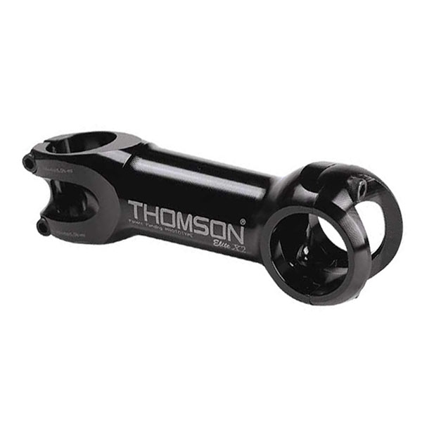

Thomson X2
Thomson has long been thought to be a top contender by many for one of the stiffest stems. The x4 definitely hit that mark, but the lighter x2 should not be expected to finish the same. 5th heaviest in terms of weight but with a good, slightly better than middle deflection, it has a stiffness to weight ratio of 7th from bottom. Available in a wide range of sizes including 10 and 17 degree and two finishes so there are a lot of fit options.
- Manufacturer: Thomson
- Model: X2
- Stack Height: 36mm
- Avg: Def: 4.2
- Weight: 146.8gr
- SxW: 1.62
- Material: 7000 Series
- Angle: 10 degree
- Price: $100
