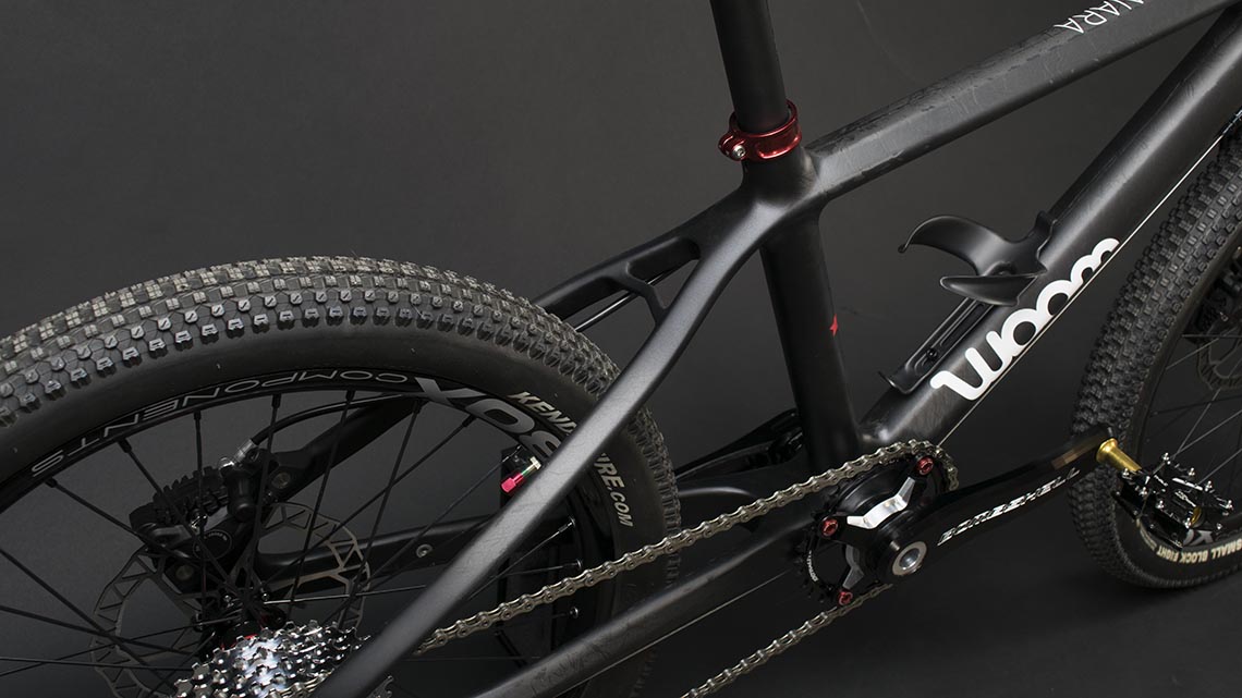

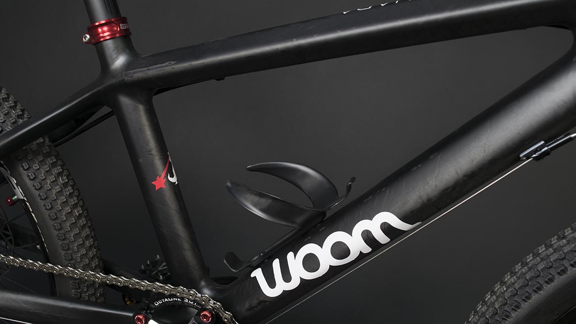

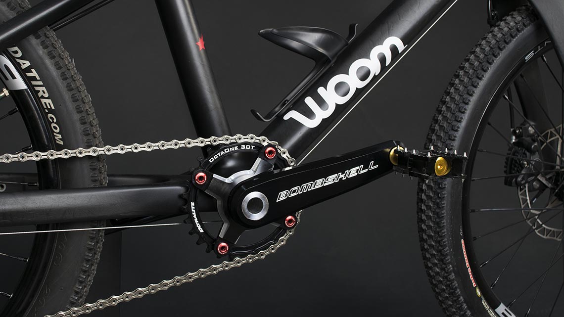

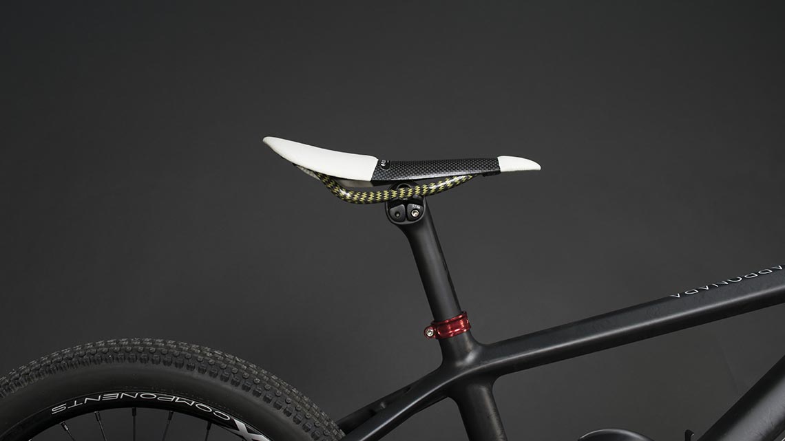

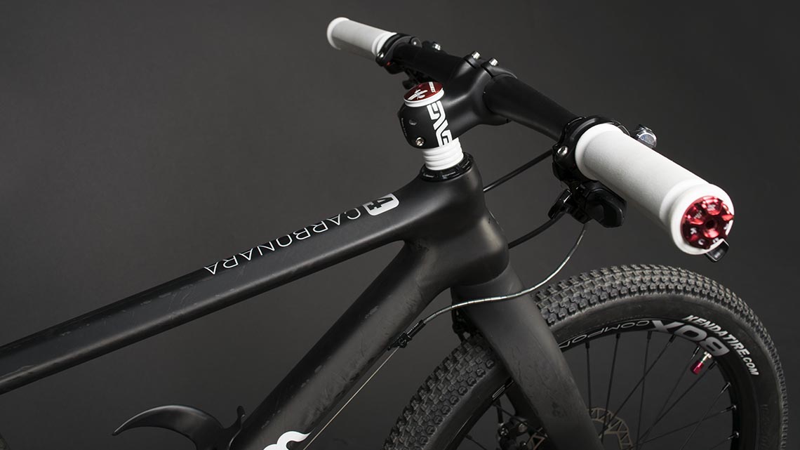

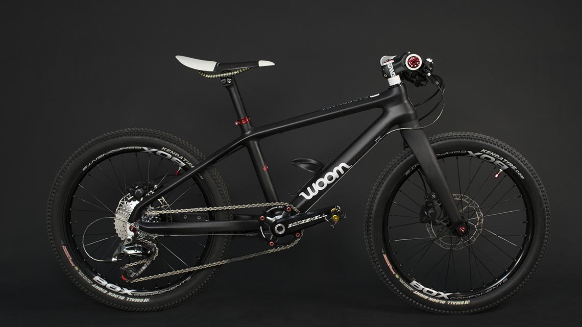

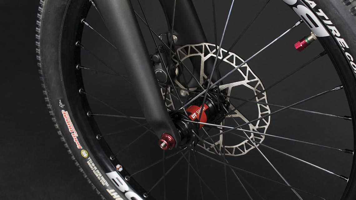

We wanted to keep doing some unique builds for our project bikes. Given that we’d never done a kids bike we decided to build up the new Carbonara from Woom, which will be released in the coming weeks. As far as we’re aware this is the first 20″ full carbon, disc brake kids bike to come to market.  The challenge with a kids bike is in keeping the weight low, which is a big factor for kids, yet at the same time keeping the durability and functionality high.  The frame came in at 947 grams.  The fork is a full carbon 1.5″ tapered fork at 380 grams.  Finished bike weight ended up at 14.2 pounds complete with pedals and cage.   Take a look and there’s a gallery of photos further down.
Woom Carbonara Build List (14.2lbs)
Frame/Fork Woom Carbonara 4. (947 grams)
Headset Kcnc Radiant Tapered
Headset spacers Parts of Passion
Crankarms Bombshell 145mm
Bottom bracket HSC Ceramic
Chainring Extralite 30T narrow wide
Chainring bolts Parts of Passion
Chain Kmc X11SL
Cassette Recon 11-32t
Rear derailleur Sram Red 22
Rear shifter Sram S-700
Shift housing Aican Bungarus
Hubs DT Swiss 240 Centerlock
Skewers Tune DC16/17
Spokes Sapim CxRay
Rims Box Focus
Tires Kenda Small Block8, 20×2.1
Rim strips Stans
Pedals Kcnc Knife Titanium
Brakes Shimano XT
Brake Rotors Kcnc Razor
Handlebar Enve Sweep Carbon
Grips Kcnc Evo
Stem Enve Carbon 55mm
Seatpost Enve Carbon 27.2
Saddle Tune Speedneedle
Seat Collar Tune Schraubwurger
Bottle Cage Fair Wheel Carbon
Final Build Weight 14.2 lbs, including pedals.
